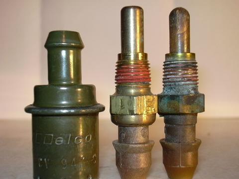

You might want to inspect the ECTS to see if it is the older plastic tipped one. If it is replace it. Jumpering it, not a good idea.
If your ECTS looks like the one on the right, replace it. If it looks like the one in the center with a bulgyer brass area in the middle, it is the newer redesigned type. You can tell the difference without removing it.
