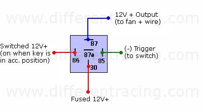

If your ECTS, relay and fan are working properly, the fan should turn on by itself at the correct temperature.
But if you must hard wire it, buy a relay and do it like this:

I believe that Wolfman's fan switch thread states that the fan on/off switch is independent of the ignition switch state. The fan will run with the ignition off if the switch is set for ON.
