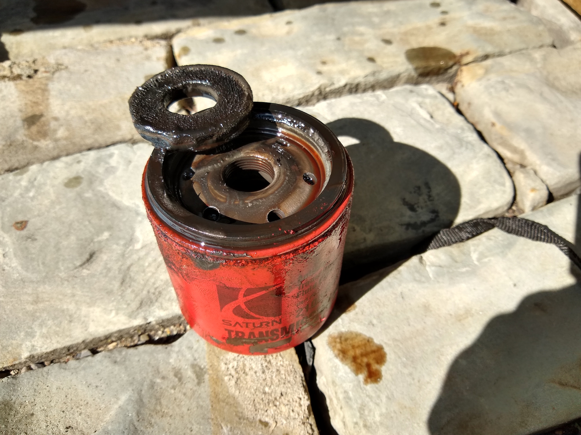

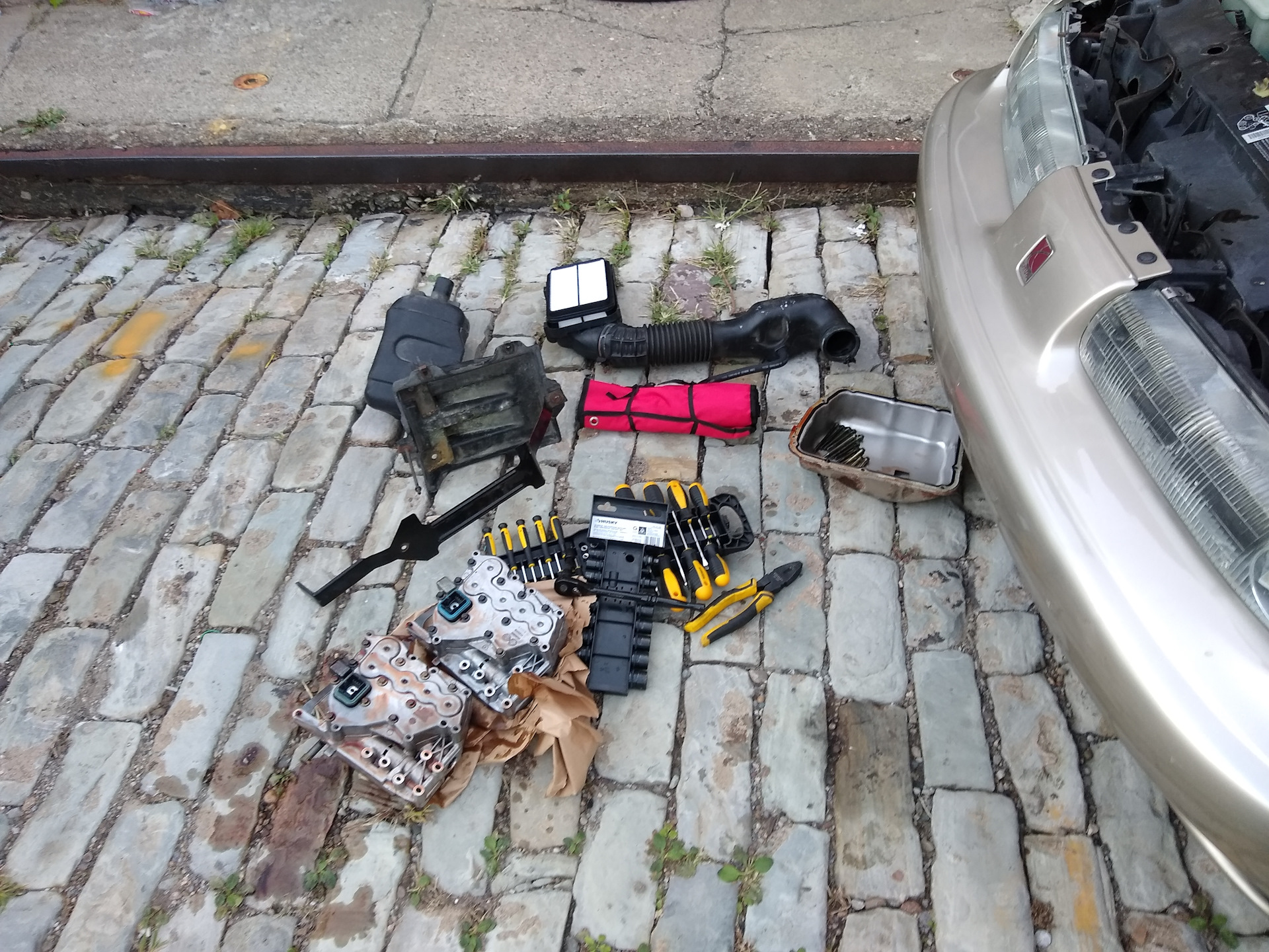

How I made it
I had a sever reverse slam on my 98' SL2. After reading on this forum I decided to replace the valve body. Got one from ebay for $127 with all the taxes.

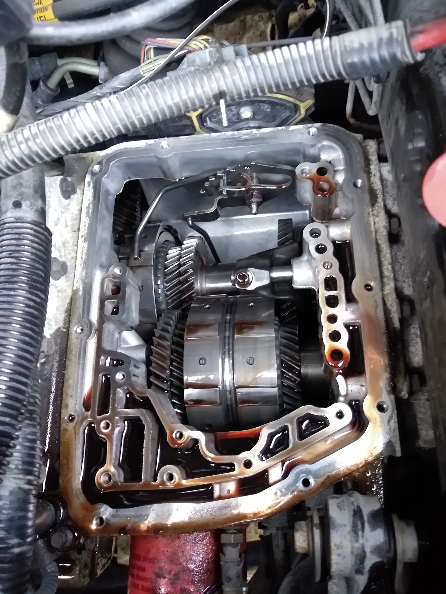

I don't think it is actually a rebuilt one because it came dirty with old ATF and the gasket was damaged (but two spares came with it). So, replaced the gasket and disassembled whatever was necessary under the hood to reach for the gearbox:
Here's the pic of my beautiful gears

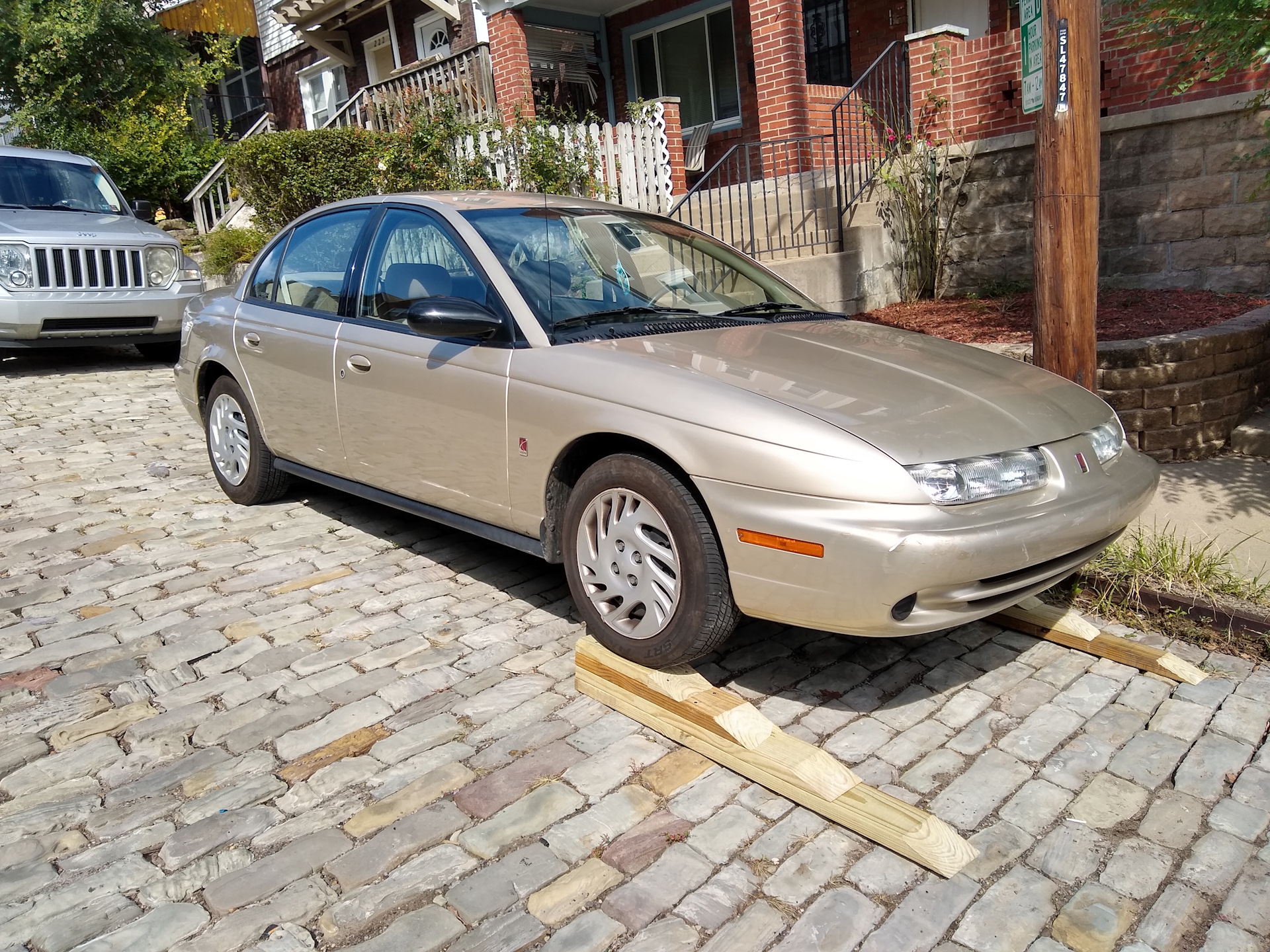

Next, I had to replace the fluid in the gearbox. To do it I first made a pair of ramps:
The gearbox filter seems to be factory original
The car has 72k miles.

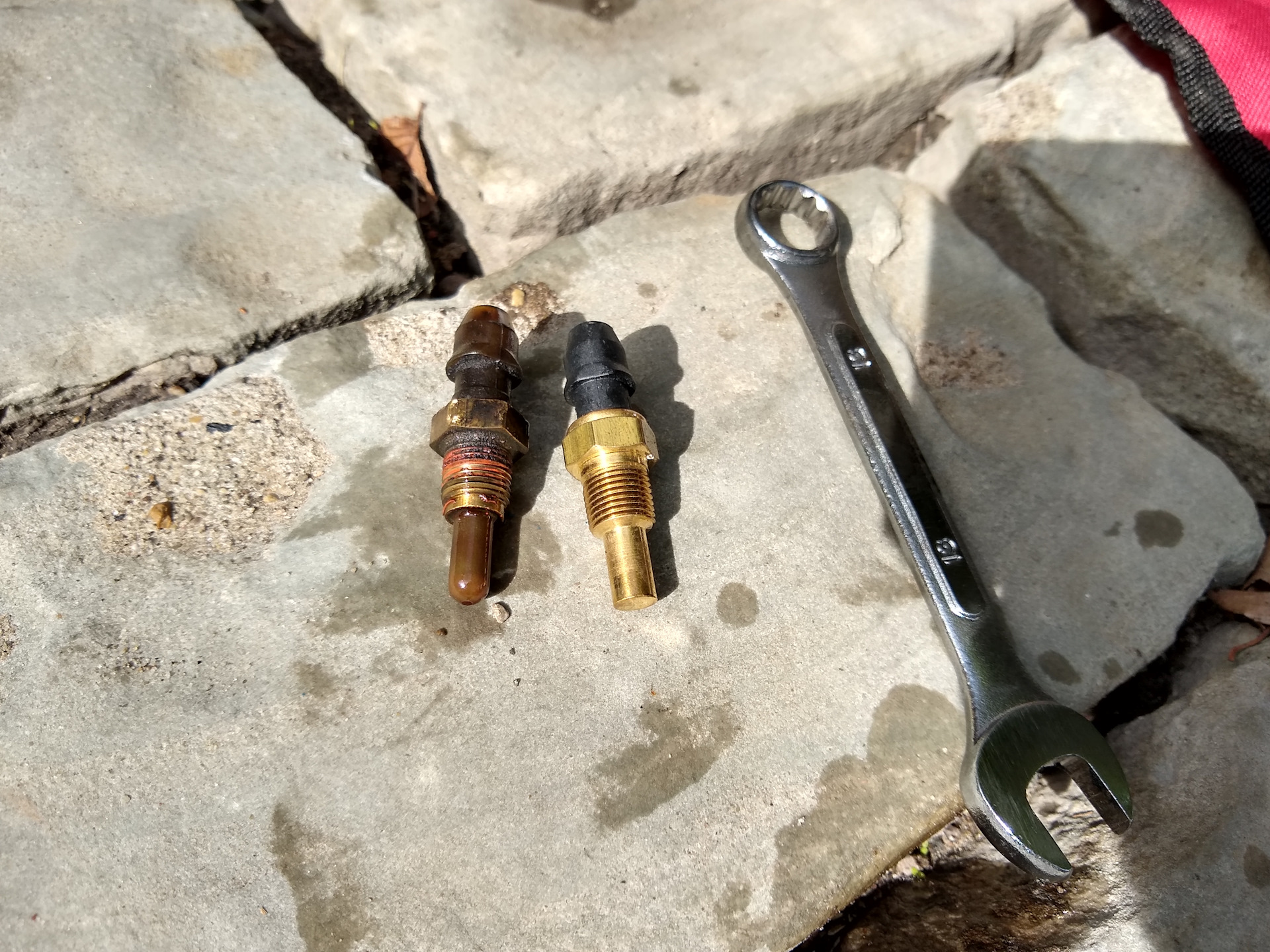

I have also replaced the gearbox temperature sensor:
The fluid I used is Castrol 03520C TRANSMAX DEX/MERC ATF, 1 Gallon. Reviews on amazon mention saturns, so I hope it won't cause any problems. That's it! No more reverse slam or any other issues with the gearbox. It shifts now so much better.
