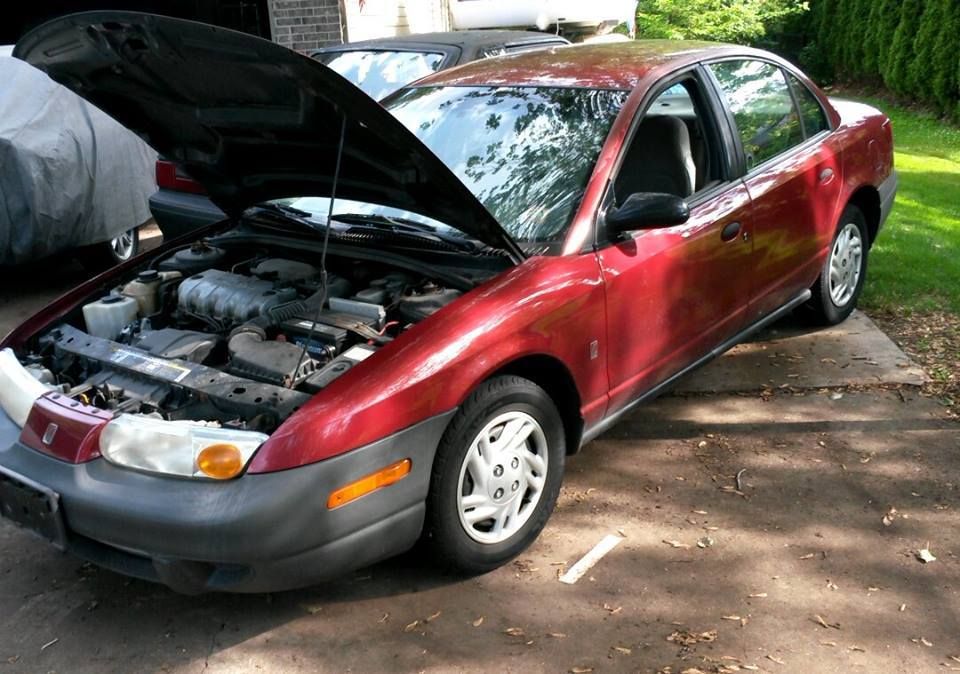

The first day I bought this car for $500 for the sole purpose to do a V8 swap in it to build the ultimate sleeper project.

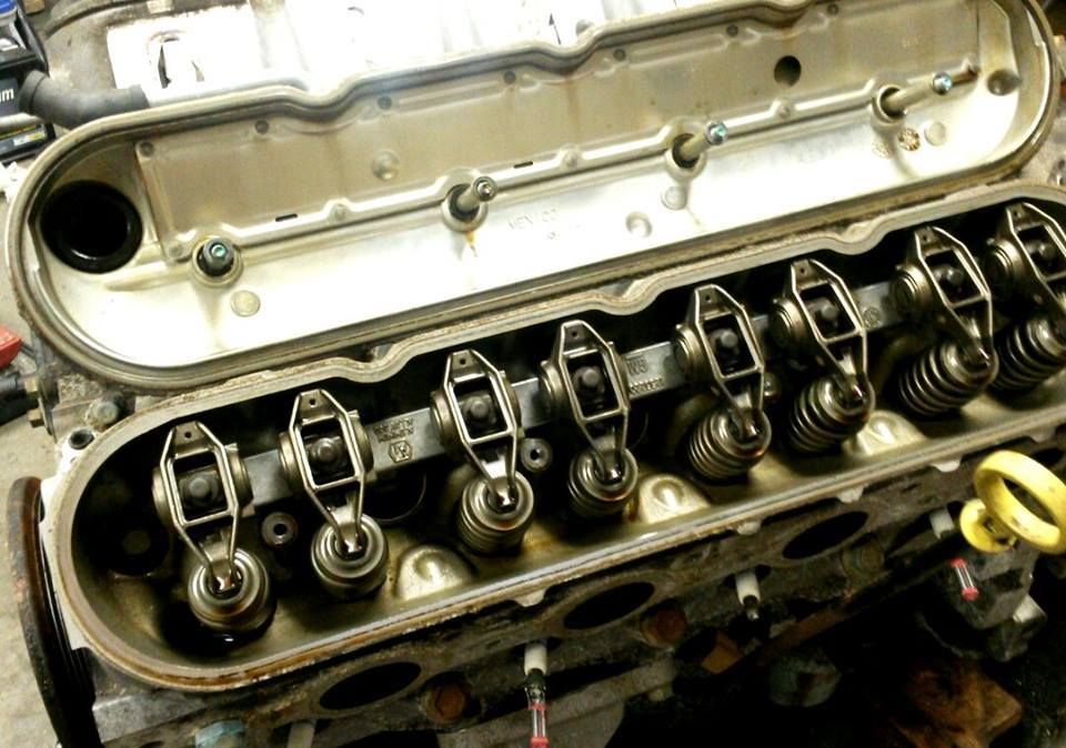

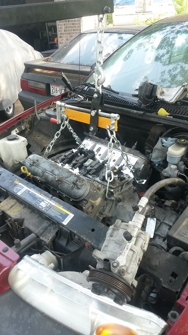

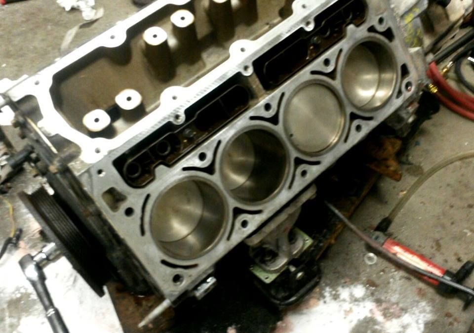

I took apart the '06 Impala SS LS4 5.3L engine to clean and swap in an LS9 cam. This is a good performing N/A camshaft, but also allows for a possible future turbo addition in the future. I also did a DoD/AFM delete and upgraded the valve springs.

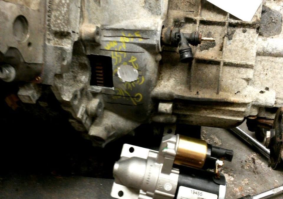

I also test-fitted the '02 Cavalier 5 speed manual transmission which is known as the F23 transmission.

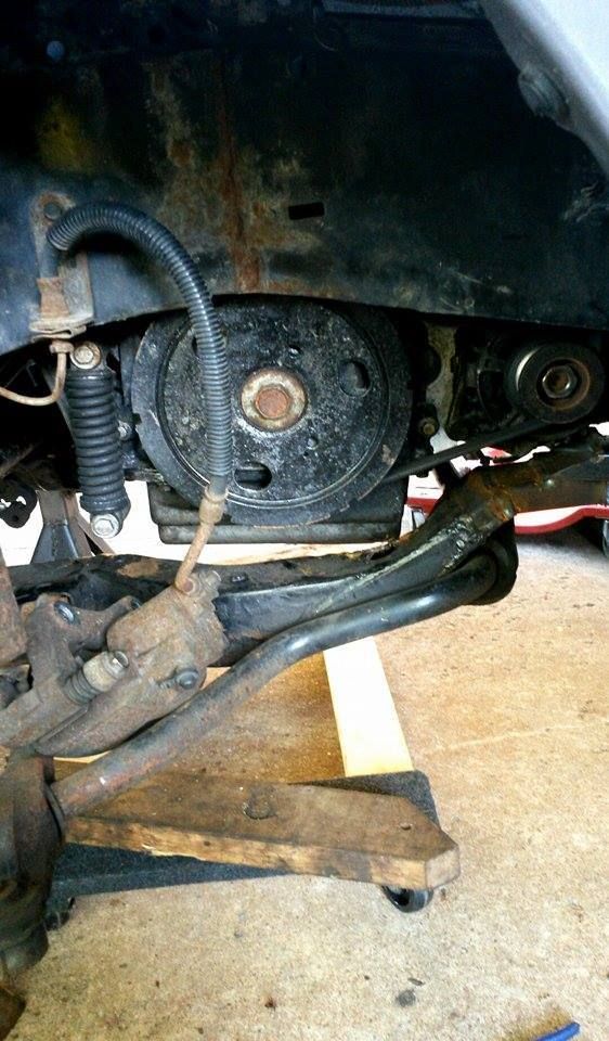

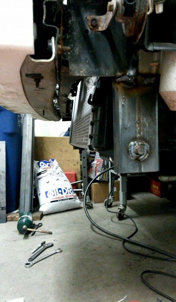

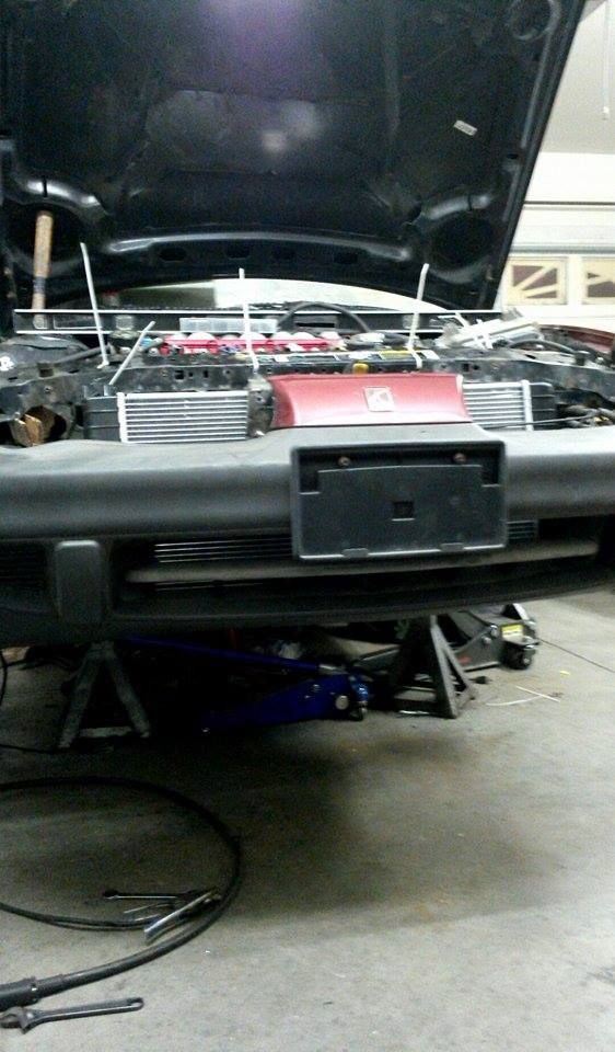

Then I started doing some test-fitting.
And here with the intake manifold and 102mm throttle body installed.

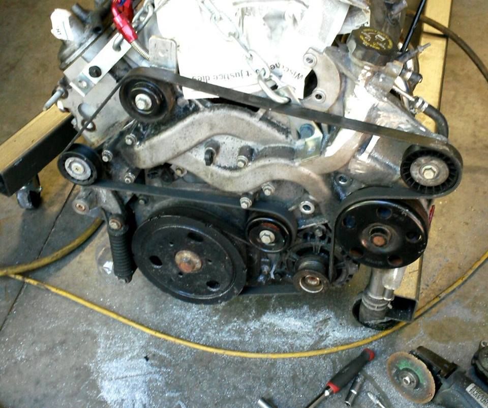

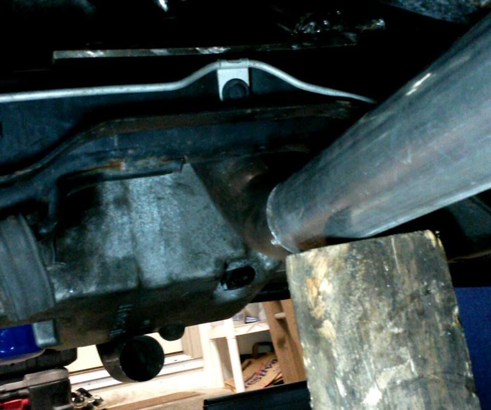

Getting the serpentine belt ran. I probably could use another ribbed idler.

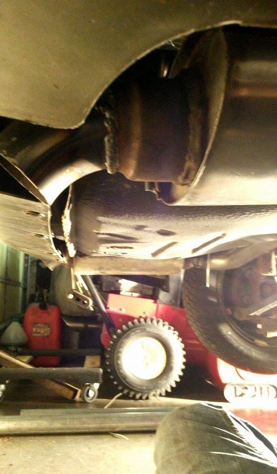

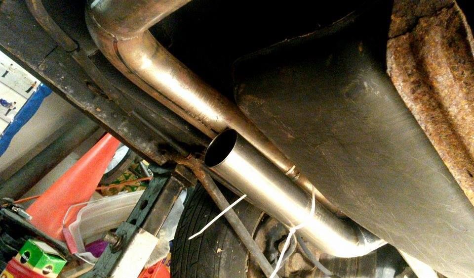

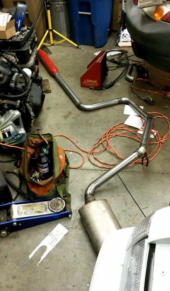

Running the exhaust was pretty tricky on this car and running dual exhaust like I did is practically a miracle.
Driver side pipe (must not have taken a picture of passenger side. oops)
Showing how the exhaust goes under the oil pan (still more clearance than stock)
The mufflers are tucked up under the bumper to hide the fact that it has a dual exhaust on it.
Here it is with full exhaust, test wiring (some stuff needs to get hooked up yet...) It runs.
