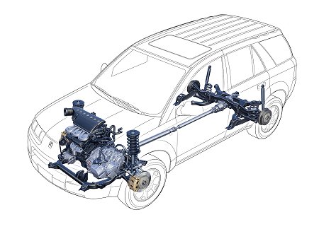

As you can see, the VUE's motor is still transversely mounted.
The tranny and AWD system is doing the magic to apply torque to all 4 wheels on demand.
Note: It still has a long drive shaft to the rear Differential.

Are those drums on the rear!? VOMIT.
Anyways, I think it would be cool to turbo this system, and put it in a car, or even lower the VUE (Got it right this time) and turn it into an AWD performance vehicle. With the ecotec in there, you have plenty of engine capability, and the AWD + room for some wider tires will give you plenty of traction.
-Travis
