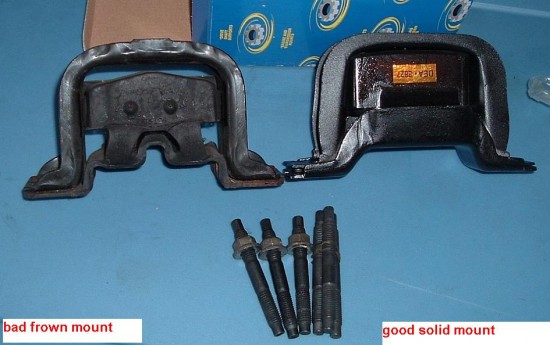

Testing the top mount depends on what type you have.
For the type on the right you put a straight edge on the surface where the valve cover meets the head, then measure up to it from the base of the mount. It should measure > 39mm. You'll need a straight edge to put on the top of the head to measure up to. It makes more sense when you look at it.
The frowny is measured by sticking a hex key in it's mouth A 2mm key should fit.
Why am I measuring it? Pardon my lack of knowledge.
When you say "deflect" does that mean i the belt should have no give when tugged anywhere on the belt?

You're measuring how much the mount has sagged from when it was new. The measurements I gave you are what the FSM authors have determined are likely to cause problems such as idle vibration.
