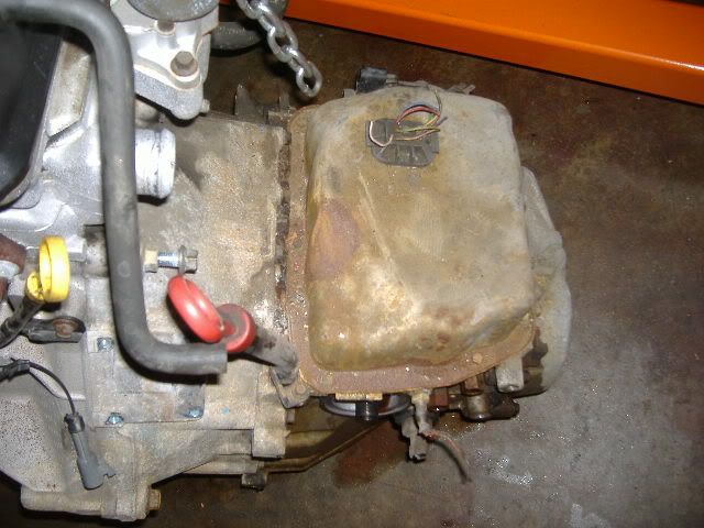

You're right. The connector is under the battery tray. You'll need to remove it. There are two 13mm bolts holding the tray in and one 13mm accessed through the driver wheel well.
Keep the red handle of the tranny dipstick in mind as a reference:
Here is the connector you want. Yours won't have the wires cut like this one does:
Here's the cleaner you want:

You dont have to remove the battery tray, just unscrew the wiring harness and spray it with electrical cleaner.
How do you get in there?
The wiring harness is to the right of the battery tray easily accessible.
