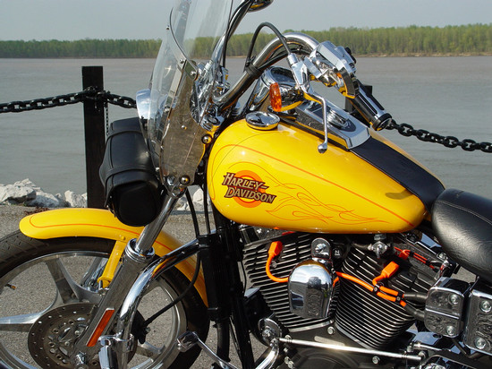

You can see the cooler just off the frame downtube in this pic. Sort of...
David Harleyson is offline
Nice.
Good point about over-cooling it. I think the Class I 4"x11" would suffice, and wouldn't block the engine radiator as much. I have been watching my engine temp guage a lot recently, and I have noticed how sitting in traffic with the a/c on, it will nudge up to almost halfway, but never over that mark. It's been close to 100 this last week, and I went from hauling ass down 35E at 85MPH to stopped, and the temp didn't spike.
I am pretty sure there is a sensor in the transmission for the temperature that can be accessed via OBD-II. I wish I had an OBD-II to USB plug and a program for my laptop or Palm so I could watch that in real time, but that's another thread, I think.
