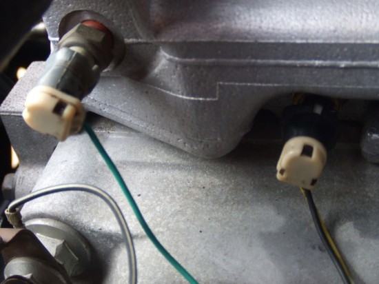

1-wire sender in the top hole....2-wire sensor in the bottom hole.
The PCM has no idea the 1-wire sender is even there, it's got a direct uninterrupted path to the temp gauge.
