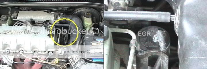

There are six parts in your 1997 EGR system:
The valve
A gasket
two bolts
The engine that it bolts onto
the wire that plugs into it.
Find the long black air tube on the driver's side that goes from behind the headlight back to the engine. Look under this about 2/3 of the way back, on the engine. There'll be a widget the size of one of those little 6 oz sodas, sitting as if the soda were upright. It'll be bright and shiny if it were replaced; dull like the rest of the car if it wasn't.
Do please post the exact PXXXX code here, too. The "code 32" you read about is 1995/older OBD-I.
